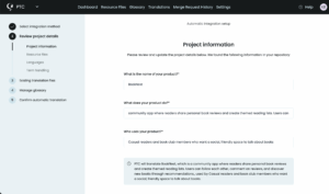

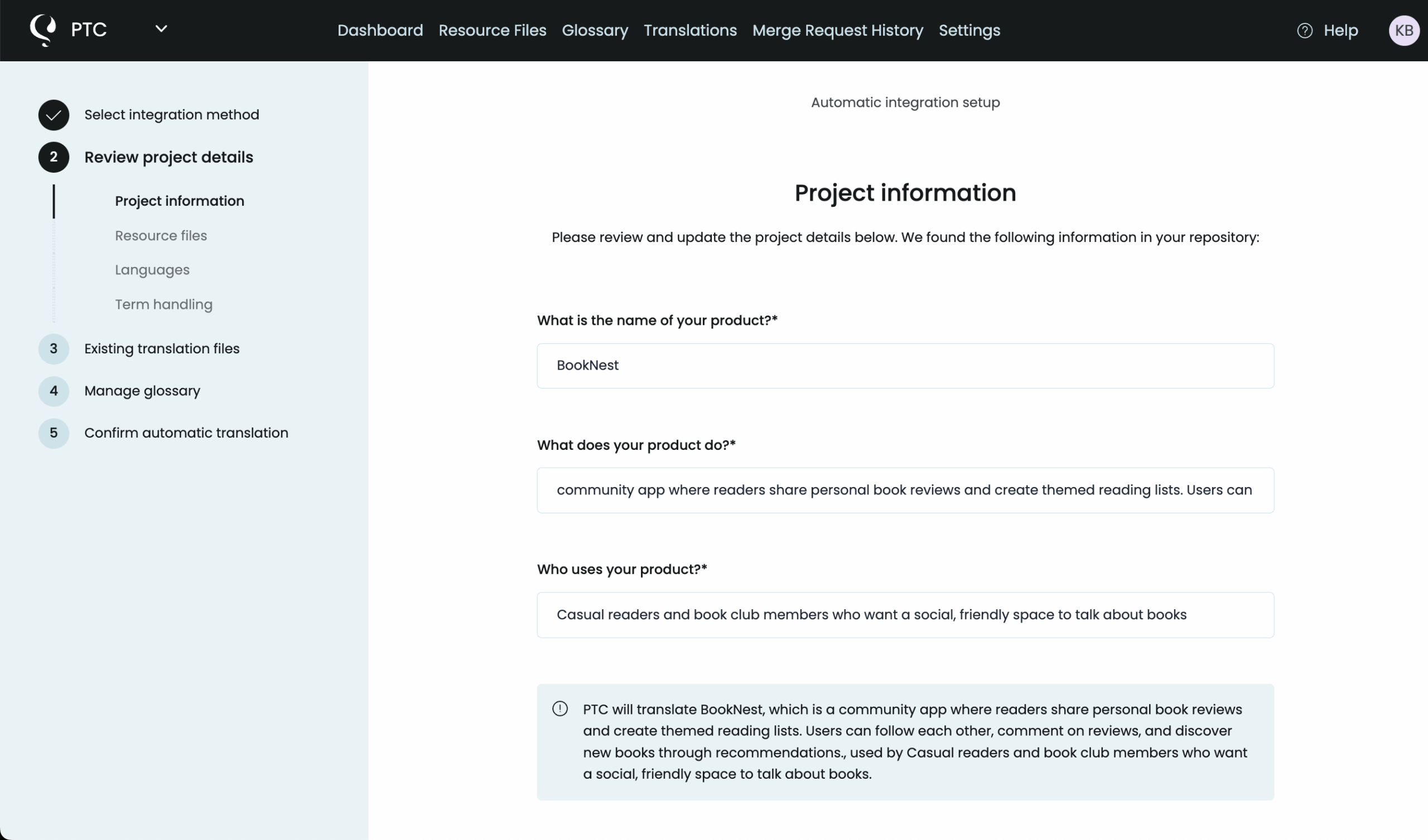

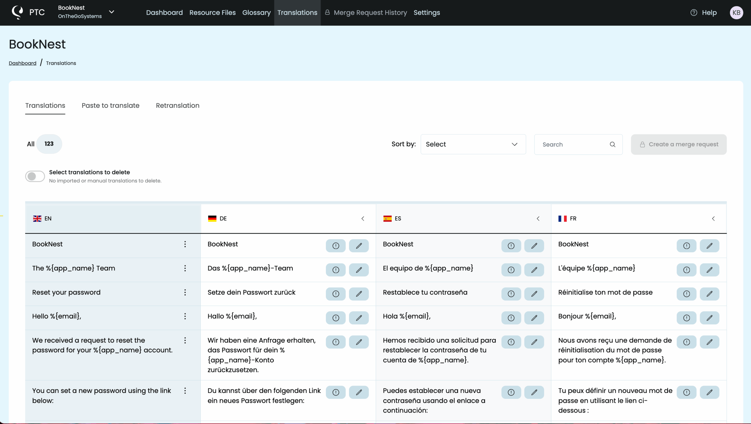

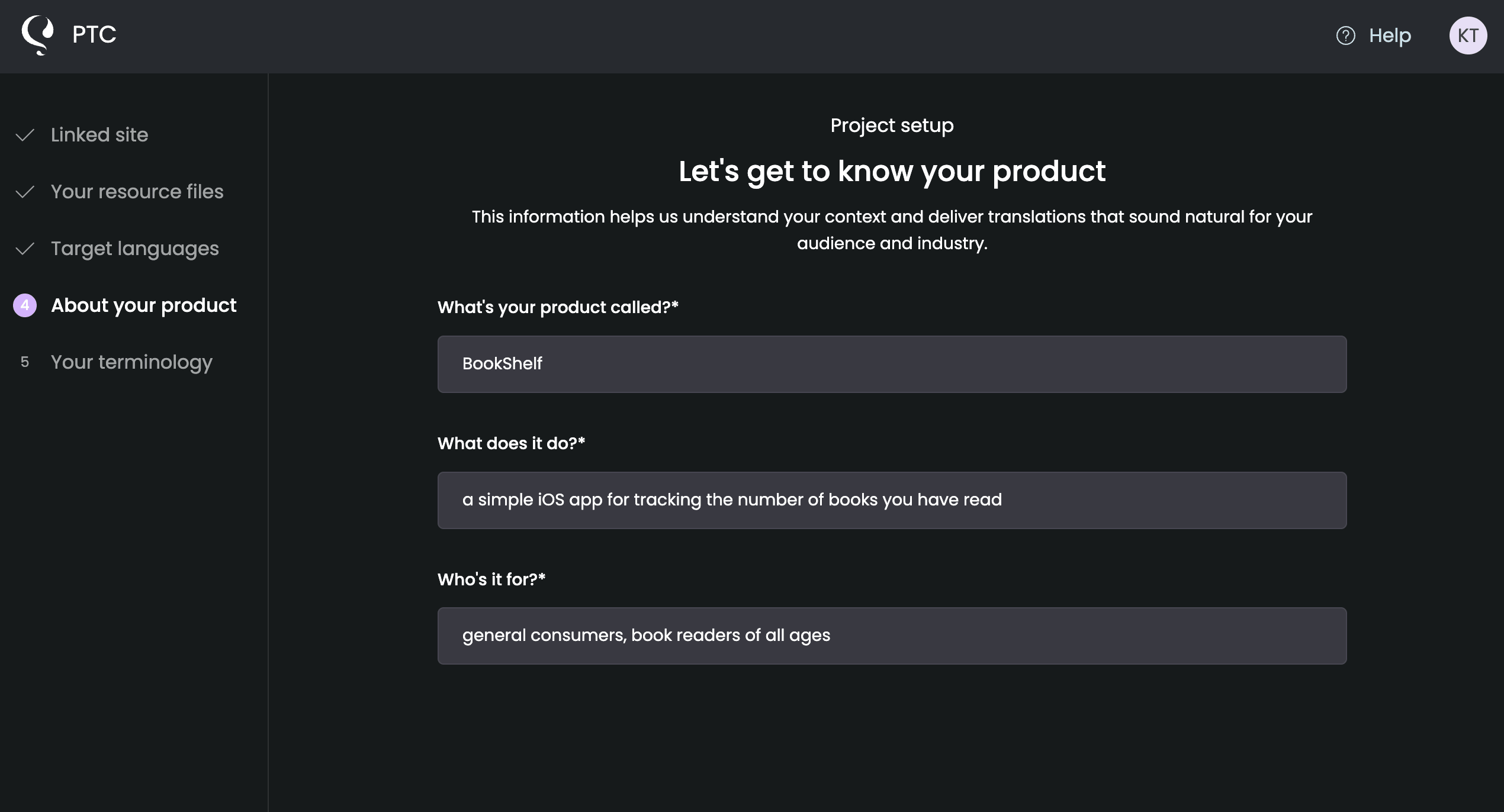

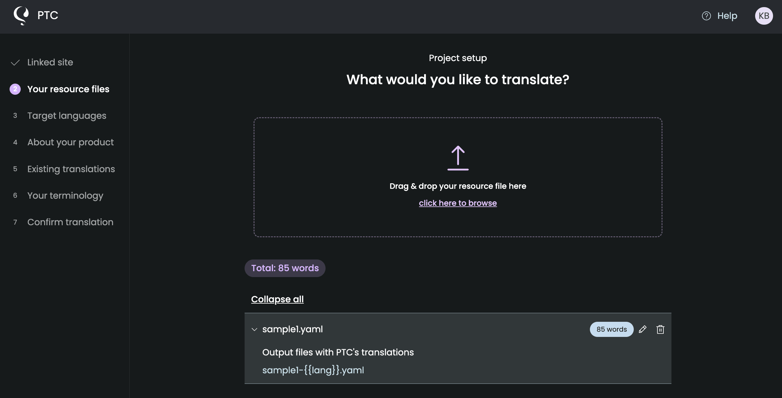

Translating Rails Apps with PTC
Now, it’s time to get translations for all your application’s text stored in the YAML file. Instead of manually translating hundreds of strings, you can use Private Translation Cloud (PTC)
PTC uses AI to automatically translate your Rails YAML files while preserving their structure and keys. You can start with the free trial,  which lets you translate 20,000 words into any two languages, no credit card required. After that, pay only for what you translate (no subscription fees).
Once you upload and translate your first file, you can move to a continuous localization workflow:
For this guide, we used Git integration for a fully automated workflow. PTC connected to our repository, created translated versions like es.yml and de.yml, and opened a pull request with the new files in the same folder.
Once you merge the pull request, Rails automatically loads the translations. When users switch languages, your app displays the correct text.
For a complete setup walkthrough, see our Getting Started Guide.
